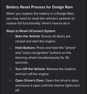

Do you have anything plugged into the 12v accessory on top of the dash?
If you getting it working, try this.
