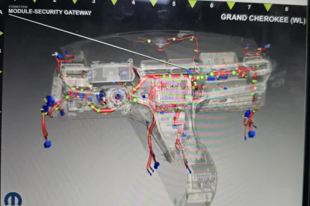

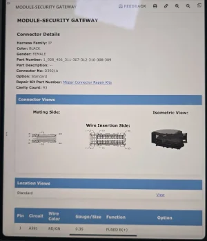

@Jimmy07 Hi Jimmy, I got the following from a contact at the dealer, the SGW is still a separate unit but uses a different connector, check this out...
Do you think there is a way to change the configuration in thr 2024 grand cherokee like we do in the RAM?
I have already figured out that there is no way to physically bypass the SGW on a 24 grand Cherokee with a wiring solution like we used to (or a 25 RHO for that matter, since they use the same sgw). The sgw must remain in place and on the network. The only way to make changes to the WL grand Cherokees is to use an OBD splitter, unlock the sgw with fca auto auth on one device that’s plugged into the obd splitter, then use alfaobd to make the changes on the other device that’s plugged into the obd splitter.
The only problem is, we’ve had some problems completing the Proxi Alignment with alfaobd after making the changes. More info in the following linked thread:
