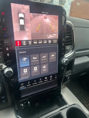

Well I finally joined the party as well .
Plenty more fights to come after this as well. I dunno why I keep doing this to myself…View attachment 154358

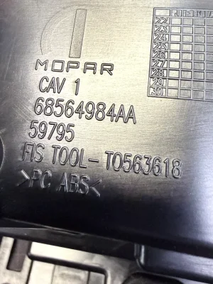

I can’t seem to locate the part that the screen mounts to, and ultimately mounts into the hole. This is what I have so far (screen, right filler, button, and lower thin bezel that the button screws into). Do you know the part number of the glossy left filler, and the part number of what the screen mounts to based on you pic?
Left trim piece: 7JA68DX8AA
Display screen bracket: 68564984AA
Seems like the bracket may be discontinued / superseded. I bought the whole thing used with all these pieces already attached so I’m not sure.
Well, that’s no bueno. I’ll have to see what Benny at allmoparparts can see for that part number.
Thanks.

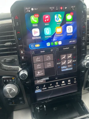

There's still a long way to go before we can say it's finished, but it's progress, and there's less and less left to do.
Ok but I tell you it looks great but I noticed on your screen you have driver modes working or even popping up
I’m wondering if I should just purchase the 14.5” screen now? Been seeing low prices on them and it seems like we are getting close🤞I don’t use my truck to tow, but I do use my aux buttons…Decisions, decisions
