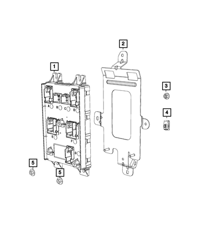

Where did you get the BCM? I had one ordered but it was cancelled due to being backordered
I had Jeremy from Retroshop order it for me. I might have hit the right time where they were available. I had thought of getting a 24 BCM but they were not available and the 23's were.
I bought my BCM on eBay. Typically if they are listed on there, they are actually available. BAM says they have two. I’d give it a shot because who knows when they will turn up again.
Hadn't thought of Ebay since it needed to be a virgin unit. Thanks boss, snagged one!

Also, ya boi got his BCM, we are in the home stretch!
when do you plan to have the bcm installed? I put it off a while after I got it, but so glad I finally got it done.
If you did the radio before the BCM, do you need to do a factory reset on the radio or a soft reset?
Edit: jk, it's a factory reset. IT LIVES!
