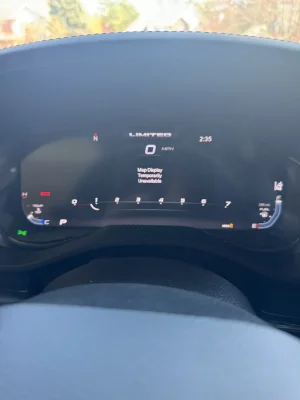

for your maps issue. I would make sure your ethernet connector in the back of the radio is 1st fully seated and then maybe try it in the 2nd slot from the usb connection. The 2nd slot is the one in the schematic, but there is thought that which slot its in shouldn't matter.
When I had mine apart recently I confirmed my Ethernet cable is in the slot closest to the USB.
@p6cl If maps aren’t loading I’d definitely check that Ethernet connection. Programming all sounds fine if you actually get the map loading page on the cluster.

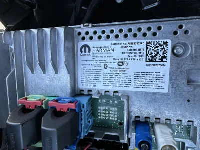

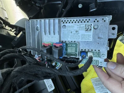

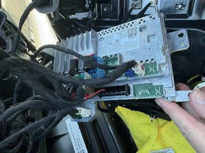

Here is some pics, I got the Radio module from a dealer. Do you think I have to do anything with AlfaOBD? With the Radio Module itself?

Here is some pics, I got the Radio module from a dealer. Do you think I have to do anything with AlphaOBD? With the Radio Module itself?

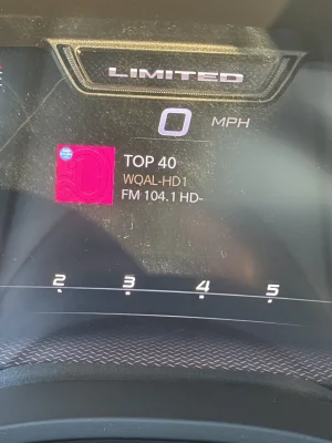

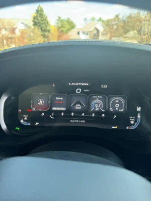

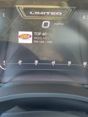

Does the album art display? Or is that not getting sent to the radio either?
You weren't really listening to that station, right? 🤣
Not all channels have the "Art" but I hate Country and Rap and Commercials so usually a USB drive and Im old 😟
Wait, why is yours saying "Limited"? Did you get the wrong BCM?

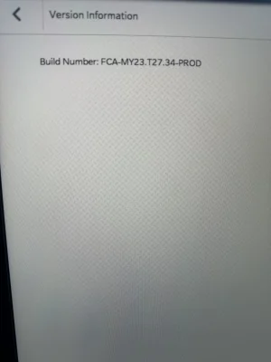

I updated radio to T27.46 just now, also Maps to latest from Dec 2023. Doubtful that will fix maps not loading.
I got it from the 5th Gen Forum. The guy that posted it got it from a dealer's computer. There are only two legit ways to get the update: 1) Have your dealer install it. 2) OTA (I realize you can't get it this way). Ram Cares asked the guy that posted it to take it down, but someone quoted his post, so that's where I got it.
Ya boi is a big chimp today. Downloaded the file, unzipped it on a 16gb drive, truck on acc, drive in usb 1, no joy. Save me @IdahoKTM
