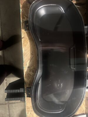

I installed the digital cluster, then we uncovered the BCM would be needed for tiles so I put the analog back in to go to the dealer. Doubt they would have noticed but if the visit went on Carfax as a service record I didn’t want the mileage listed at 100 or whatever the digital cluster had at that point.

to those swapped to digital cluster from 2022, when you checked the RAM app, does it show the original mileage on your old cluster or swapped digital cluster. This is concerning to me, and it may be a reason to deny entire vehicle warranty based on inaccuracy of mileage calculations.
I just checked the Ram app. It now has the mileage of new cluster.
if you ever go to dealer or any service center, previous readings will show odometer rollback?
That I do not know. I don't visit the dealer at all unless it absolutely necessary. Which the BCM replacement might be me only time going
That’s seems just stupid as it’s like the cluster is the brain now for milage, and not the pcm or bcm or all the uploads to ramcares.
can you please re-install and check the mileage if it shows the digital cluster or the old #'s please? If it shows the old # we are good but if it's new one that would be so dumb that it checks the value from the cluster
it should also send you an updated monthly report not sure if it's been a month since you swapped.
Checked the Ram email, can confirm it's the cluster mileage as well.
