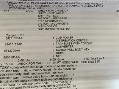

Got my truck back today. Nothing really to report from the old noise standpoint..we’ll see the next time I drive it when I can replicate the conditions for it to happen. I’ve attached a photo of the repair order that shows the parts that were replaced.
the trans part number ending in AB suggests it is an updated part, at least from what was originally specified when the TRX was first released. I'll have to check mine and see if its AA or AB
Or they just changed the part number like they do routinely
I've not heard of this. why would they change the part number if it wasnt updated in some capacity? Literally the only times I've seen updated part numbers after 10+ years of Ram ownership is after a change is applied
Happens all of the time. Why I couldn’t tell you but in 30+ years of Mopar vehicle ownership they routinely change part numbers for the same part with zero changes.
Sometimes it’s as simple as they created X amount of the AA run of a part and the next run is AB. I recently changed a part on my 392 and it was identical to the previous part but had a new part number. I doubt Ram is going to admit they made any functional changes to the transmission even if you ask.
