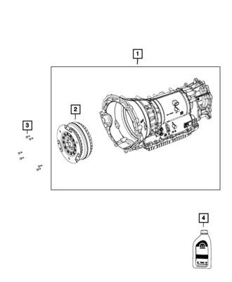

Looks like the current part number for the HP95 transmission is 68430191AB which says it was updated once but who knows when. Anyone know approximately when Stellantis switched from the AA part number?
