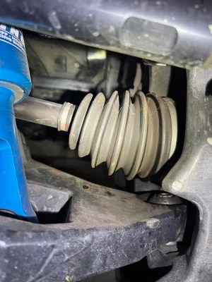

Dang we're almost the same # of axles! We're around 17-18 axles now but ours last a bit longer than yours. We're getting at least 8k to max of around 15k miles btwn axles (with the exception of 1 defective OEM one and 1 crappy aftermarket one). Can you take a few pics of the boots on ur RCVs when u get a chance? Also, are you around stock HP and do you offroad yours?
Yes I'll get some pics and send them over this evening. I'm also on 37s and kings shocks and I have kibbetech whole front end and have the dusterhoff 937 flex package. I Offroad maybe 3-4 times a year but most of my blown cvs have happened just cruising around on the road. I will say I absolutely rip it everywhere I drive and I do jump the truck as often as I can when I find a good spot on the road.

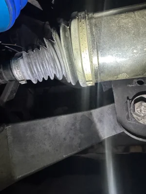

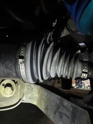

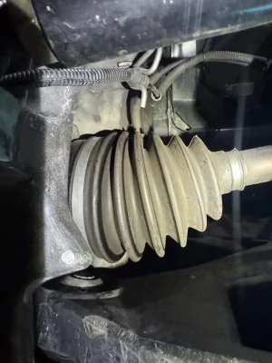

Here's the pics of the rcv boots for you

Boots look MUCH more supple than the OEM ones. Nice rounded accordions lol. Hard to tell in the 1 pic but is that boot almost touching the lower control arm?
