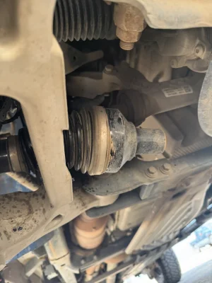

Was accelerating after a toll booth, maybe 40mph. Felt like a flat tire in the front right. Pulled over and saw this.. The engine has a bad sound too now, hard to explain but a rattle that i've never heard before. Will update.
hey guys. My CV axle came off as well. I have no idea what caused it to happen. Here’s a picture.

Literally what happened to me! I hope you get that fixed without much issue. What were you doing when it happened? Yours looks way cleaner/less destroyed than mine.
