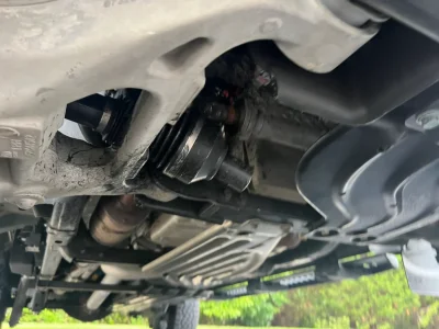

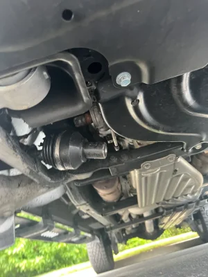

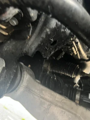

My right front CV just fell right off today while cruising through a toll booth
Damn, sorry man that's not good. Was the cv making any noise before it left the chat? I've started to notice a slight popping noise from the driver front on mine. Have an appointment at the dealer next week because I can't figure out where it's coming from, wondering if it's the CV...
Did the stub axle pull out of the diff? Or did the cv snap?
There’s a new part number for the OEM CV axles. 68679812aa. Still feels like the same shitty boots.
Really no signs, no noise or anything at all. The dealer replaced the front right CV boot at the wheel because it had torn, a few months ago. This time it appears it disconnected from the other end. Ill post a pic or two
Was accelerating after a toll booth, maybe 40mph. Felt like a flat tire in the front right. Pulled over and saw this.. The engine has a bad sound too now, hard to explain but a rattle that i've never heard before. Will update.
Holy crap man! That engine sound is probably actually the front diff. There's a real chance your front diff is compromised since your CV grenaded itself. If you dont catch a bad CV in time, it chews up that front diff. Glad ur okay!
