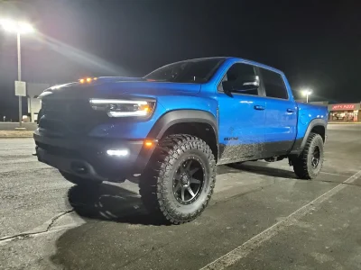

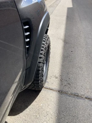

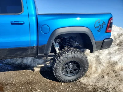

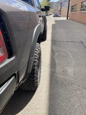

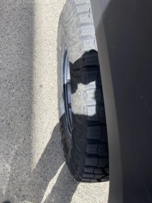

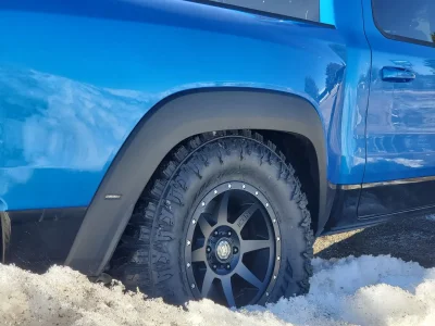

Has any ran a 18x9 or 20x9 with 0 offset ? Would like to see the fitment.
Icon Rebound 18x9 with 0 offset, Atturo Boss 37x13.5R18 tires. No/minimal rubbing on level ground. Uneven ground or offroad will definitely rub.
I will soon be mounting 18x9 0 offset With 35’s. Stay tuned.
it will be just like catchme’s
Is that due to +20mm offset, no rubbing or just flat street driving and no rubbing?
thanks
I have not tested it offroad but normal driving and pulling in and out of inclined areas I have not rubbed. I think @CatchMeOffroad rubbed slightly but he had 0mm offset. I ran the +20 to try and get zero rub (which so far I have had no rubbing).

Icon Rebound titanium 18X9, 0 offset
These wheels really pulled this truck together.

So nobody has noticed the what I did in the rear wheel wells?
