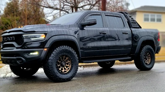

Thanks for again edifying me. And what size is that wheel if I can be so bold to inquire?
Same as stock, 18 x 9, but with 0 offset compared to the stock wheel which has a 19mm offset, so it sits 19mm further out.

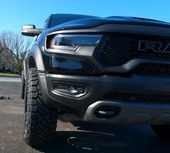

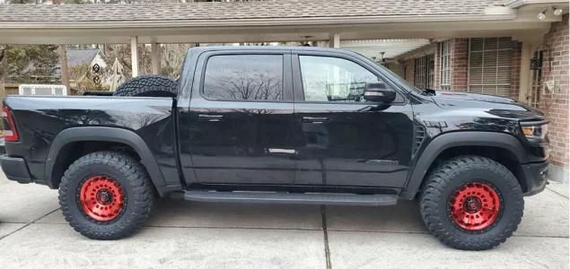

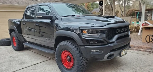

It shouldn't since I managed to fit 20x9 Fuels with the same offset and a 37x13.50 Toyo MT.
Ya I misread. Thought he was going 0mm offset. So was curious on rubbing with 37x1250
Fuel Zephyr 20x9, +20 offset
37x13.50r20 Toyo MT
No rubbing.

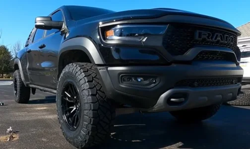

Hey CP, does the front wheels stick out further than the rear? In other words are they more flush with the fenders?
The offset of that set up is actually 1mm further inboard than stock, but with the added sidewall bulge of the Toyo MT they fill out the wheel wells a bit better. In terms of front to back "poke" it will be the same ratio as stock. This pic will be similar since these wheels are +18 offset and the red Zephyrs are +20. These wheels stick out 2mm more than the Zephyr.

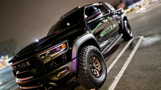

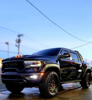

37x13.50r20 Nitto Tires
20 inch Covert Fuel Rims with a 20 offset

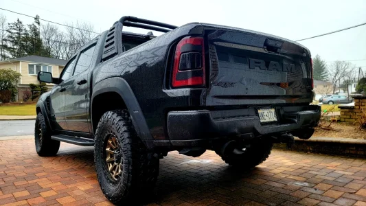

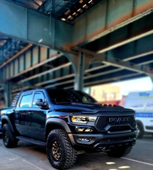

Anyone see streetspeed's 2nd TRX wheel/tire combo? Seems similar to Customperformance's, but maybe more offset?
Would like: 37x13.5, 20x10, -18 - Think it will rub like crazy though, just love that wider wheel.
We know works: 37x13.5, 20x9, +20
SS Setup?: 37x12.5, 20x9, +1 or +20?
May have to settle if it will it work with : 37x13.5, 20x9, +1
