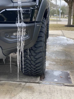

Here is my contribution:
Trimming required: None
That look really good. Can you post a side shot from front to back to see how much it stick out ?

Thanks. No noticeable performance difference, but I only ran the stock tires for about 40 miles. I can say it's plenty fast with 37s on it. I'll try and get a pic from front to back. The wheel offset is the same, so any additional poke outwards is going to come from the sidewall pattern and tire width. It's not substantial, but it fills up the wheel well really nice.
I think it's just about perfect. It's more the trophy truck look where the fenders cover the tires. It's pretty flush.
