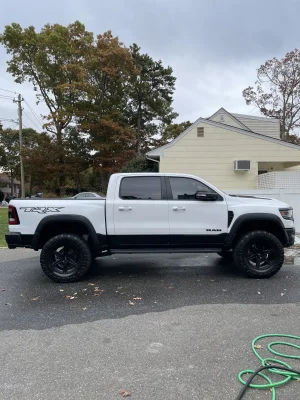

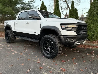

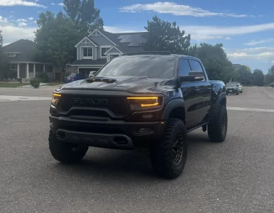

Yes. I'm running 22x10, -18 offset Vossens with 12.5x 35 nitto reacon rubbers. No rubbing what so ever. Quiet too!
Can you post a pic please, looking at the same setup.
Thanks a lot, love the look. I like the concave, are those deep or super deep. I also we they have an ultra deep but I’m guessing that’s at -44 offset only.
Thanks! They are just deep, if you want super deep you have to go -44 offset. I like the look of -44 better than -18 but you will have 3+ inches of poke and the sides of your truck will be chipped and dented to shit from rocks.
Edit: I forgot to mention-18 offset gives you 1" of poke.

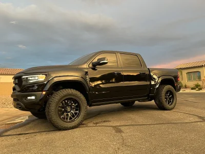

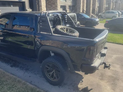

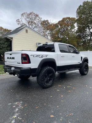

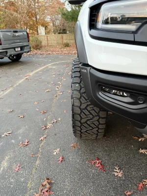

Looking to pick up a set of HFX-1, 20x10 - 18 wrapped with 325/60 Ridge Grapplers. I’d like to keep the stock suspension set up and am hoping I won’t have to trim anything for this set up. Can anyone confirm either way? Just coming off a lifted 2024 GMC AT4 HD which rode like a washing machine so I’m really enjoying the ride quality of the TRX and don’t want to mess with it. Any advice is appreciated.
I run that exact tire in that exact size on stock suspension with -19 offset wheels (20x10). It does slightly rub but I’ve never trimmed anything because it’s very minor.

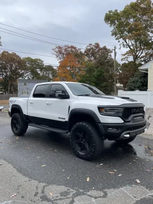

Running this exact setup. 20x10 -18. 325/60 ridge grapplers. Like everyone else, rubs at full left lock. Only sometimes though depending on the angle if the road and the weight of the truck. Very minor.

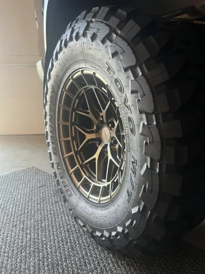

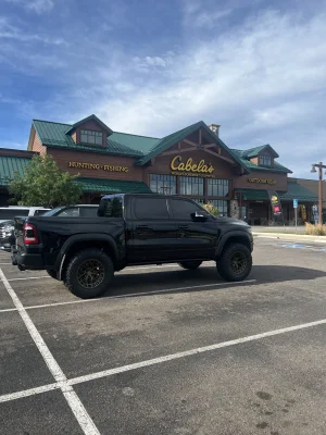

Here is my contribution:
Trimming required: None
Vossen HFX-1 on Toyo MT 38x13.5x20

Looks great. What suspension mods did you do to clear 38s? What is the offset on those wheels? How much did you have to trim?
I did the Eibach Pro springs, slight trimming on the front bumper and some work on the rear of the front wheel wells. Rubs slightly at full turn but nothing crazy.

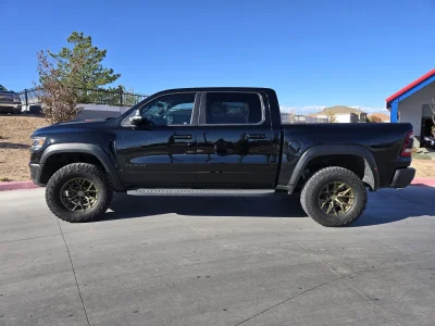

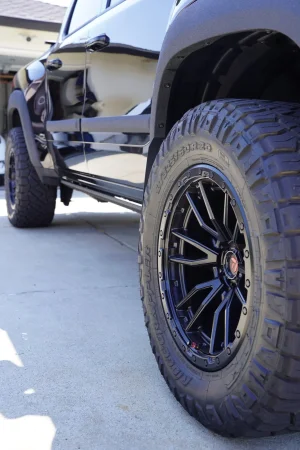

Had 20” vossens with 37x13.50’s, just took them off to sell them.
Switched to 22” Hostiles with 37x13.50’s, I believe 20x10 -25mm offset. Or -24mm. Somewhere around there
