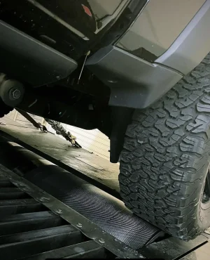

What number did it put down on the dyno? The guy's face seemed to indicate it was impressive!
Not sure as 1221 Wheels did a custom setup on my TRX. I told them I wanted a 1/2” poke. I believe they’re 10 or 10.5” wide.
A bit over 800 whp in 4th gear, high heat & humidity (~2300 DA that day, I’m at sea level though), on 36” tires hanging halfway off the rollers. Was at 15.5 psi. In 6th (1 to 1 gear ratio) & with proper traction, it’s probably closer to 900whp, but tire speed rating prevented them from doing a 6th gear pull. I intend to pulley down further in the future.
