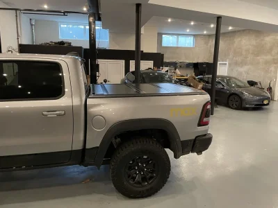

Johnny,
Thank you very much for getting me Pace Edwards Matte Black UltraGroove Electric Metal Tonneau. It works and looks good. Highly recommended.

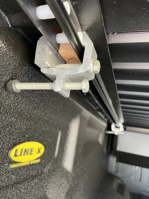

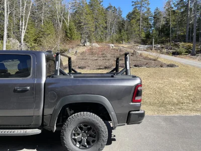

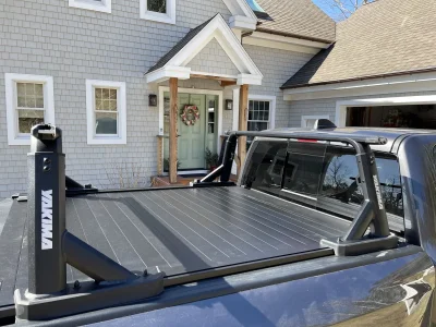

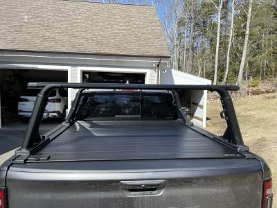

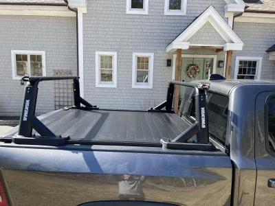

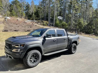

Finally got the tonneau cover installed and the Yakima racks. One issue I had on the retrax pro was the back clamps that hold it to the inside of the bed. The clamps were hitting an indent and would not seat all the way to the top. So I put them in front of the plastic spacers. And made up a couple of 15/16 x 2x 1 blocks that slid up between the cover and bed frame. Then tightened them up for a solid support. Attached a few pics. Time for a beer

Looks great! I just installed mine yesterday. Fits perfectly. Thanks @Johnny@JustBoltOns !!

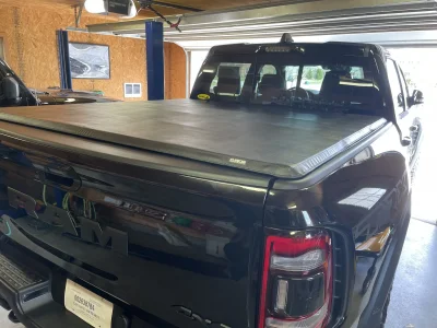

After trying to get a cap somewhere near me for a reasonable cost, I decided to go with a cover. Being that my bed is used for some recovery equipment and the difference between a cap I liked and the Gator cover was like three grand I finally went with a gator and will spend the cash on other mods :cool:

Same issue I had - the good topper caps seem to be long back ordered.

That looks really good!

Can you use the digital mirror at all, or is that out of the question with this setup? The mirror seems ideal as a solution to having stuff on your rack or having a camper shell, but need a way to relocate the camera to the back.

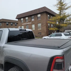

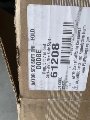

I went cheap. Had one before and liked it. Gator SFX.
