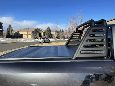

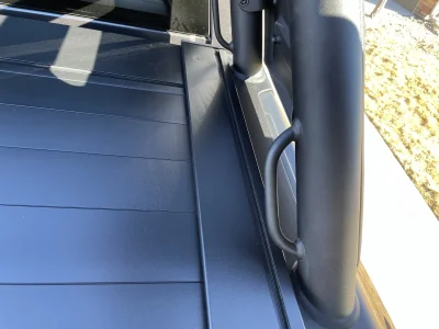

Here are some photos with the retrax pro XR installed with the Rambar.
Notice in the photos I added some additional foam padding underneath the tonneau cover so it transitions nicely sitting on top of the rambar and on top of the truck bed rails. This is because the Rambar sticks up almost 1/8 of an inch on top of the bed rail and wanted the tonneau cover to have a clean look.
If you zoom in closely there’s about 3/8 of an inch of gap between the Rambar posts and the edge of the tonneau cover.
Looks like it was made to fit a tonneau cover nicely!
