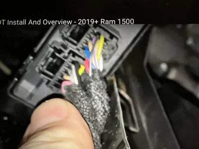

Does anyone have a picture of where you plug in the TazerDT?
I just started messing with the Tazer today. When those are unplugged and the Tazer is there, what doesn't work? What are those plugs for?
