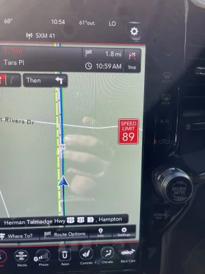

Anyone got a picture of the SGW that they’re unplugging and plugging into the Tazer? Left and up of the OBD is what I am thinking but this is my replacement that I got and is also not working so I must be doing something wrong.
Here are the new speed limits in GA when you have a Tazer on a TRX, lol. Wouldn’t that be nice!!!
