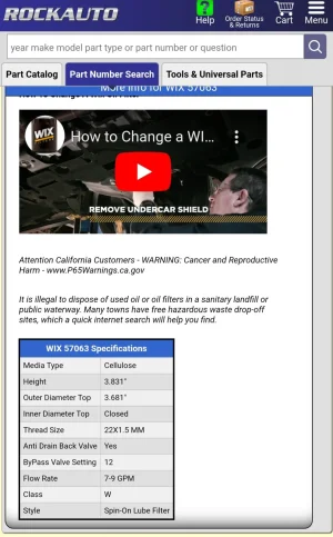

Sorry stated that wrong. Not srt filter
51372 out flows and has higher bypass than srt filter.
When i called wix the rep ssid he doesn't even have information for the micron. Which means they dont hold it to a tight standard.
There is a thread somewhere on here about filter comparisons.

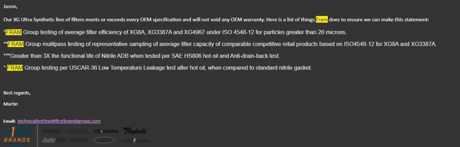

Assuming the Fram meets warranty requirements, and I can't see why it wouldn't I'd try them.
So interestingly enough, I had the same thought.. The op manual says the filter must meet SAE-USCAR-36, but I could not find this anywhere on any of the aftermarket or RAM oil filters. I emailed Fram asking about it, this was their response. (in case anyone else is curious)

It's good to know they even responded back, and the answer seems good. they are American made and that's reassuring as well.
Seem like they're worth a try to me.

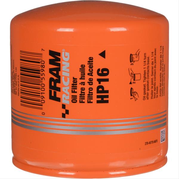

anyone try a fram Hp16 ?
