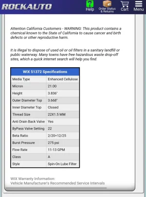

Wix 51372
22psi bypass
11-13gmp flow
Works great for trx
$5.73 @ piece or
box of 12 $61.56
Rockauto.com
Srt filter
Be careful with Fram.
In the past ive had the plastic come out and media get stuck.
The WIX SRT equivalent is 57063 for whatever that’s worth. The regular WIX is a nice filter too. Just stay away from the XP, efficiency is absolutely terrible.
