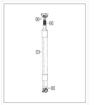

Anyone have the part numbers for the flange yokes to stock drive shaft?
Quick search I see the only options to order are the bolts, boot or the full driveshaft
yeah, I see the same thing on the MOPAR website. See some things on eBay but I need a part number to cross reference.
I didn’t see a part number on the yokes. There was a “DT” marking on the shaft-side yoke. But other than that, the only identifier was the Mopar part number sticker (for the driveshaft).

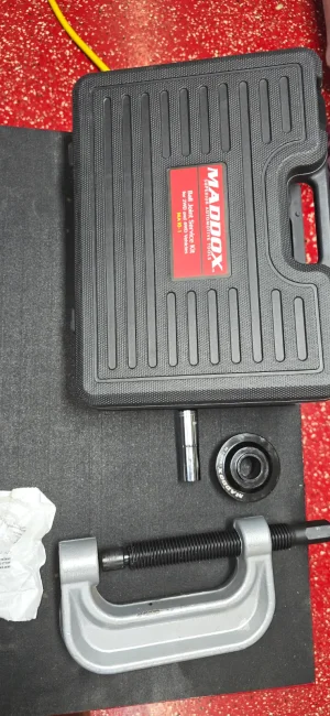

I hope you didn't actually beat it out with a socket, lol. I tried this the first time and mine was not budging. I would have been there 3 hours just to do that part. The one time use tool was well worth the $80 for my peace of mind.
I used a gear puller with some assistance from a hammer to help budge it. But I also used a socket as the cups got looser (it was faster than tightening the gear puller). Also used the socket to tap everything back together.

I would buy this tool and preferably have an extra set of hands. Also, make sure you have a wrench that can get to the bolts for tightening when putting the driveshaft back in. My air rachet was able to take of the bolts but was not able to fit to put them back in.
Yes, good point. Even my larger box-end wrench didn't work for the bolts that were sandwiched between the driveshaft and the body. I had to pull out a short wrench (and could still only crank 1/6 of a turn at a time).
