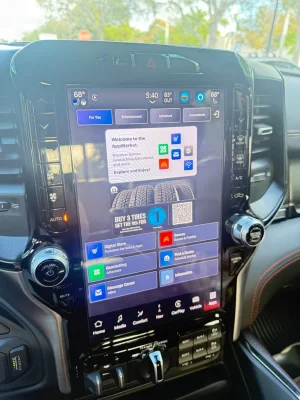

This shit just popped up today, wtf.
App market trying to sell crap.
Yeah that showed up on my truck last Friday, I believe. It is good that they are pushing out updates over the air, however, it is just a shame it is not the updates anyone wants….
...AND this piece of crap icon can't be removed. I use a usb key for music, and that is where the song name was listed. So literally they deleted a function to replace it with this crap! I'm glad we can vent here, but it is really getting to the point of no return.
