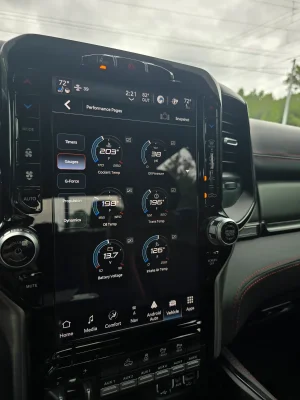

You do have to give it some time after update to pick up the correct vehicle features. Things like the weird temperature displays and missing performance pages will work themselves out. Factory reset helps it along.

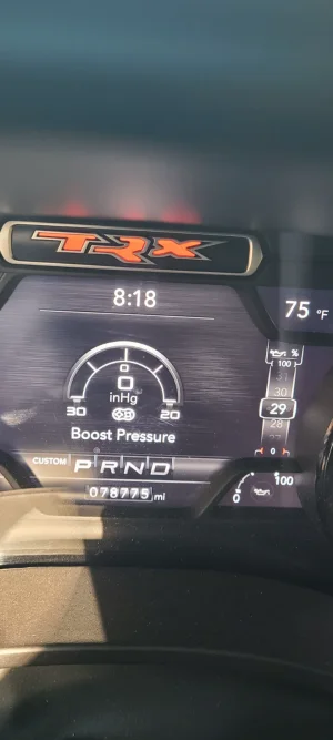

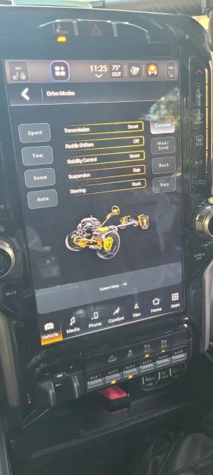

I tried to avoid the update but it took yesterday. So far (as reported by many) the V8 graphic is fixed, however ... lost gauges, race cooling, all options for suspension changes....and so far, only the AUTO setting can be altered whatsoever. Did get the climate graphic back but oddly, the AM radio does not work at all (probably come back at some point). Overall a total fail. Because the TRX is such a sweet package overall, living with the clunk, missing interior lights, and misaligned body panels has been tolerable as I can fix them myself and move on. But these continual update fails actually bother me more as I can't correct them and I use the messed up pages and options all the time. Going back to previous software versions seems like a no brainer but RAM refuses (or is incapable?) of doing that. Combined with seeing the myriad of unresolved RHO issues, Barring a major course correction, I really can't imagine ever choosing another CJDR vehicle again....
Mine just did an update a hour ago. Nothing I could do to stop it. It went full retard after the update. I went thru all the pages to see what had changed then did a raido reset. I did this 4 times. Each time something changed. On the 4th reset it seems the update has settled in.

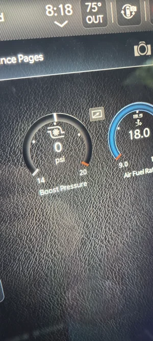

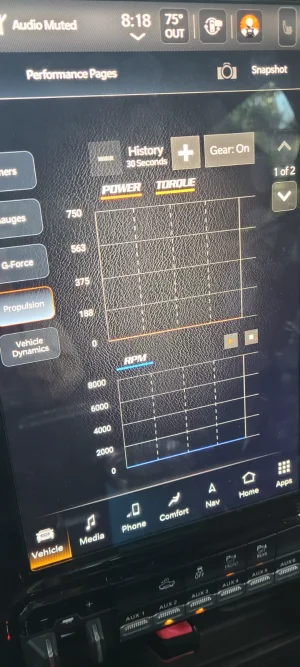

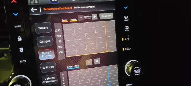

My engine icon changed to the V6 on a previous update and would bounce back and forth from the V8 to V6 then a few days later back again. It is back to the V8 at the moment. Most of my gauges that vanished, came back except I now have a turbo on the boost gauge on the radio and twin screws on the dash gauge. My hp chart dropped from 1500 scale to 750hp scale
The auto start disable control button that showed after the update changed to a mirror dimmer button after the 3rd raido reset.

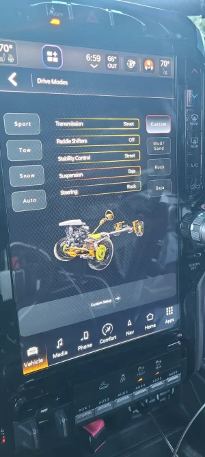

Checked yesterday and had 29.44 with RHO graphics, woke up to 35.26 with the same graphics. The gauges seem to be the same for me with one page, but not really sure what Im supposed to have being I hardly go into the performance pages. The one thing that has now changed is as others have said, when changing driving modes it goes back to auto, but when I looked I'm in the mode I selected, it just doesn't indicate that on the 12" screen, but does on the other at the wheel. Not sure if that's true for everyone, but for me it is.
