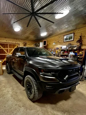

your trucks looks great.

That‘s awesome news man.
Agreed with the awesomeness of the truck, it is a testament to how much joy driving it gives me that it hasn’t been sold already.
