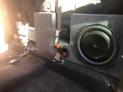

Love this thread and appreciate all the info. I haven't gotten my TRX yet but in the planning stages for when I do. I take it that I wont be able to take my custom JL system I put in my F250 with me to the TRX? For those that have their vehicles, is there not enough space behind seats for system pictured? Thanks for info. Look forward to following this and what others have done.
Unfortunately there isn’t enough room behind the seats for any type of sub box. You need to go under the seat and can can more room by using a seat riser.
Figured that was going to be the case. That JL sub has been amazing. I hate to lose the under seat storage but...
I put a JL Stealthbox under my rear seat, never missed not being able to throw anything underneath there. I have seen boxes that house a single 10/12 sub and only take up half of the underseat storage.
Thanks, I agree. Doubt I would really miss it as well. Will probably go the full box route.
I'm not 100% sure you couldn't with the sub you have pictured there. That particular sub only needs 2.6" of mounting depth so with 3/4" HDF, you could be close to four inches and you don't even need one cubic foot. Is your box there four inches plus at the base? It actually might fit if you got the upgraded trim package that has reclining seats. My amps fit but even they were a tight squeeze.
Get some measurements and let's just see even though it seems improbable.

I do have the reclining seats! I will measure and see what I come up with. That would be great if I could get it to fit! Thanks for the input Jackson.
If you have a Level 2 with reclining seats - will the stealth box with the 2-12’s not fit or will you just lose the reclining functionality?
