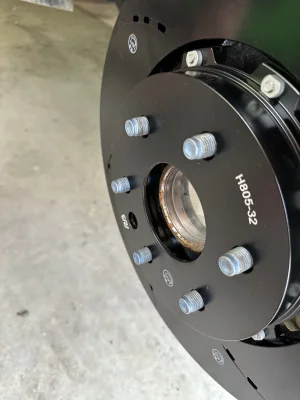

FYI #2 the rear rotors do not fit over the existing factory axle hardware, I emailed RB to see what they can do.
Please update thread with what their resolution is...maybe I have time to change my GB #2 to leave the rears out.
So not sure what the res. will be but they are working on it/replied right away. I will likely end up just returning these as I don’t see a way which they end up fitting.

I received an update from RB. The rotor hats are the same size(186mm OD) for both front and rear, to fit a hub size of 183mm OD. The rear hubs are surprisingly larger than the front hubs. This is a first for RB, even with their decades of experience.

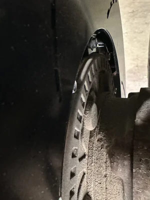

It looks like this step in the rear hub could be culprit:
They should have sent our return labels to anyone who ordered rear rotors. You will be able to send the rear set back either for a refund or exchange for a correct set (ETA 2-3 wks). Please make sure to send the rotors back in the same orientation they were shipped, hat-to-hat.

It's indeed very odd that the rear hub is larger than the front. One local customer offers his TRX to check the rear hub size for a corrective action - All shipped orders will be exchanged, and GB#2 orders will be shipped with a correct fitment.
Jon T. was kind enough to lend us his TRX so we had a full access and measurement on the hub for an immediate corrective action.
There was a plate behind the regular hub which is measured as 194mm in diameter (vs. hub OD of 183mm) that the rotor hat inner diameter must clear to have the rotor hat seats properly.
Side view
Back view. - It looks like a speed sensor/ABS ring
A proper rotor hat has been re-designed and already released to production.

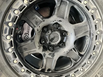

Some pics from Jon T. install.
Got through some first drive impressions yesterday. All my sentiments are positive. For context, I got the front caliper kit, which includes the XT910 pads that Warren referenced, but reuses the OE rotors. I only have 16k miles on my rig, so I didn't want to replace the OE rotors unnecessarily.
Install: It took about 3 low stress hours to install, very casually, including removing all wheels, flushing the brake fluid on all 4 corners (with Motul RBF-600), etc.
Bedding: Instructions for bedding the pads are included and were fairly easy to do safely. 6-8 brakings from 35 to 25mph + 3-4 brakings from 55 to 40mph + 10-15 minutes cool down, which I did by coasting on the highway to pick my buddy up from the airport.
Actual usage: My main intent was to improve the brake feel, as I felt the OE brakes were not confidence inspiring at all. That goal was absolutely achieved with just the front caliper replacement. The pedal is significantly firmer and it's easier to modulate the brakes, which results in a better handling car, since I can have more precise control of the brakes when going into a turn (some context: I drive road courses like Watkins Glen, VIR, Summit Point in a 911 GT3 with AP Racing calipers, so I really, really like using my brakes to load up the front to turn in [not just to stop]). In highway driving, I felt more confident driving at higher speeds and when going onto ramps, I felt comfortable approaching with more speed than usual, knowing I could shed the speed before the turn began. Framed differently, if the truck had came this way, no one would be complaining about the brakes. Also, the balance of the car is still 100%, which I assume is a factor of the strategic piston area that this setup was designed to have. Conversely, in my JL Wrangler (with a Magnuson Supercharger), I have 6 piston Baer front calipers w/ OE rear calipers, and while they do their job, there is absolutely a ton more front brake bias than the car came with. I've altered my driving habits to adapt to that, so no big deal, but it's nice having the OE balance with this RacingBrake kit, especially considering I do intend to tow and use this truck for other utility. Value wise, the front caliper upgrade feels like a no brainer to me. Framed differently, if it was offered as a factory option for the MSRP of this upgrade, I think nearly everyone would tick the box.
I don't really intend to do any 70 to 0 stops or equivalent, as that's simply not how I use this truck, but I'm glad to help answer any subjective questions if I can be helpful in that way.
Looks: They look great! The factory beadlock wheels cover up the bulk of the caliper, so it's more a subtle thing.
View attachment 124801View attachment 124802View attachment 124803
-Anu
PS: I installed a rear sway bar at the same time as these brakes, which made a very significant improvement in on-road handling. With the brakes + sway bar, it's like this car got some upgraded handling option that should have been offered from the factory.
