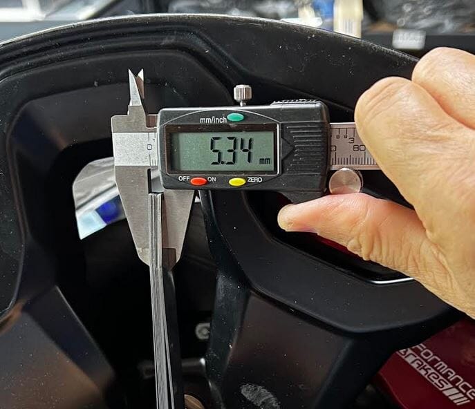

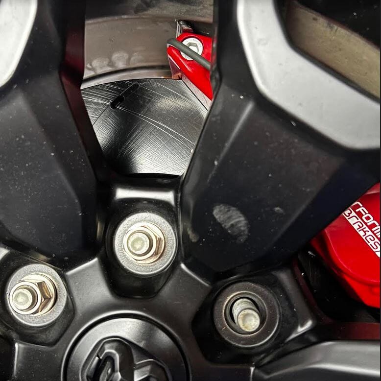

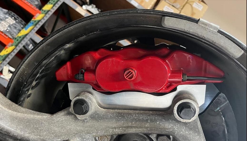

Update: 1/24/24
A wheel clearance test is performed today with a prototype caliper adaptor.
  • Test was done with a feeler gage for the tightest spot between the caliper body and the wheel barrel.
  • The clearance is measured as 5.34mm (0.21")
  • Behind the scene.
This brake project works better than expected (eg. Actual clearance & GB).
The caliper adaptor design will be finalized for the production release, so we are still looking for a shipment in about 3-4 weeks.
A big thanks to all GB participants and Steve for his effort in organizing it and answering all questions.
We look forward to working with your on ordering and shipment.
Hi Warren. From these tests, could you confirm if the Track rotors would fit under OEM wheel?

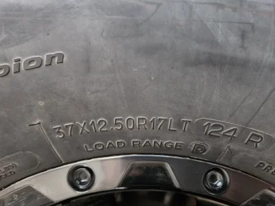

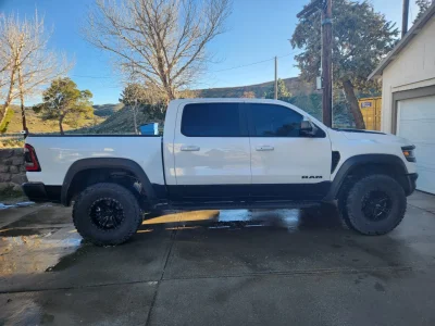

I went 17's so for the smoother ride and extra side wall in my opinion the ride is significantly smoother off-road especially when running baja mode which is very stiff. I didn't do any fancy kit I just took a grinder to my stock caliper and have been running my 17's without issue for over 10k miles so far. I also drag race and make some very hard stops as my local track has a short shut down.
Thank you for sharing.
Do you also have to graind down the rear calipers?
Any pics of the calipers?
