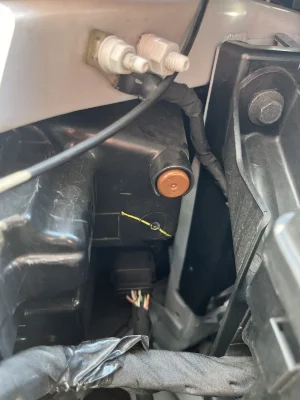

Hi fellow TRX’ers,
I searched everything under brakes on the form and did not find this particular concern. The brakes on these trucks are obviously not ideal but I have a strange concern. When I apply the brakes, it feels like the peddle is soft and depresses farther than it should. Sometimes like it simply does not have firm peddle pressure/resistance. I can let off and reapply (like pumping the peddle) and the resistance is much firmer. Anyone else ?
I checked the fluid reservoir and it is full.
Thanks
I have an update on the pedal pressure concern. I asked the dealer to have a look at the last oil change and they said was as it was supposed to be and there is a vacuum assist on supercharged engines for the brakes and as the supercharger pulls vacuum it can affect the braking. I still did not believe it was correct (totally) so I started poking around for a vacuum leak. I found this (not sure the part) but the orange cap was barely on. So, I seated it properly and my pedal pressure is now consistent and as I feel it should have been all along. So, question of the group, what part is this exactly? It is right behind the drivers headlight.
