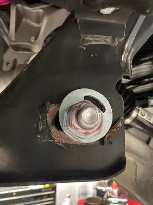

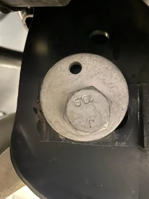

I have had a clunk in my front end ever since new when going through a deep pot hole or dropping off a curb and am curious if anyone here haas the same issue and if anyone has found a fix. I saw a video in one of the facebook groups and a number of people commented that they have the same issue. To me it sounds as though a strut mount is loose but I have not had a chance to get it to the dealer to check it out.

@Trx415 are the alignment restrictive tabs ripped off?
Were you offroad when that happened or hitting curbs?
Either way, find a good offroad fab shop and have them weld plates there like they do for raptors and gm’s.
Nut was probably loose for awhile, egged out the hole and ripped out the tabs.
I have not taken the truck off road. I was just driving the truck as my daily. My intention was to take the truck on winter hunts for white tail and ducks. Now I’m scared to take it on any trip!

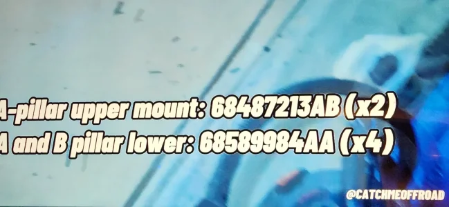

Hey guys, I suspect a lot of the noises many of you are hearing are related to the body mounts - here is a video showing the noise, its cause, and the fix:
TLDR; All 2021 and most 2022 TRX's used the same body mounts as the standard 5th gen Ram 1500, but were later upgraded to mounts with thicker and stiffer rubber (to reduce/remove air gap between body and frame) starting around Oct 2022. If you hear a metal-on-metal knocking sound while offroading or hitting potholes, this is very likely the culprit. Part numbers for new mounts in video, and some useful ordering info in the comments. Hope this helps...
Thanks for posting @CatchMeOffroad , I was about to look up your video and do the same. Your fix worked for me! No more pops/clunks when hitting potholes.
