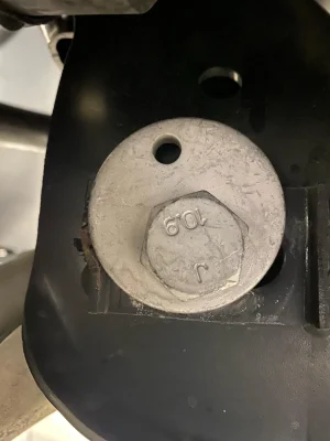

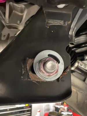

This is my clunk! Front passenger side control arm! Now the dealership is telling me to fix on my own. They even had the nerve to tell me to make a claim on my own insurance! I also purchased the additional warranty coverage. I’m so disappointed with Ram, Stellantis FCA.
After seeing 2 different dealerships. They gave me a phone number to complain. WOW!
This is a Baja race truck that can’t handle the street’s and freeways and pot hole! I would never recommend this truck when Ram has no care for the product and warranty!
