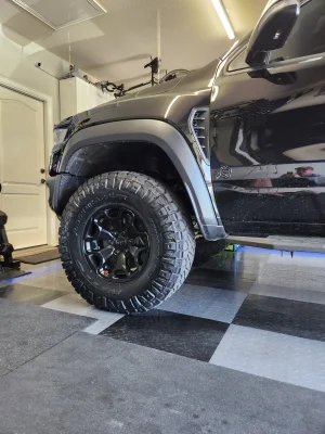

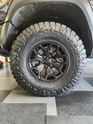

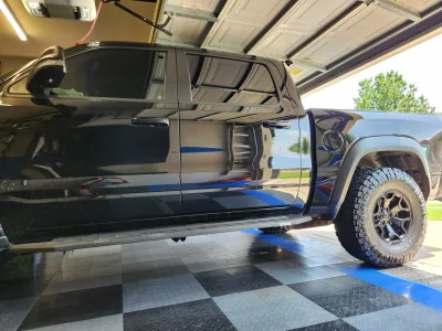

Just finished installing the spacers (and Rocklights).
37x12.50r18 with 1.5” Spacers on OEM Wheels (effective offset is -18)
The look is exactly as it should be… the Rub is real.
So the bad…. There is rub…
The outside edge of the tire catches that bolt… which sucks cause the fit finally looks right…
Looking into having some trimming done.

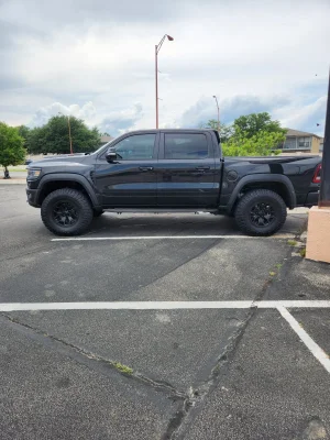

Refreshing this thread for anyone on the fence. I was lucky enough to meet @ORCowboy (and his wonderful wife) yesterday and see his truck. The stance with 37’s and the Pro-Lift is perfect. It doesn’t look “over lifted” at all, it is fairly subtle. Kinda like, why does this stance look so much better than the others I have seen? His truck is the best looking TRX I’ve seen in person. Besides the $$ I spent on his Beadlocks, he cost me several more thousand $$ in bumpers, lights, tires, springs, ……..😂😂
