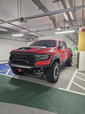

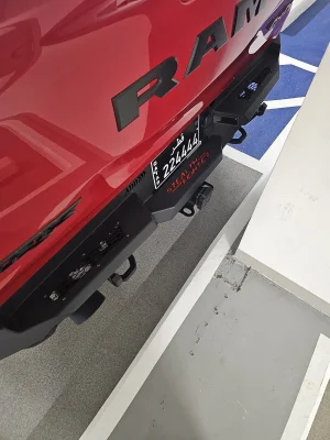

I would love to see someone feedback on running upgraded leveling springs and how it would improve the situation if you have a winch.
I currently run Add stealth fighter front and rear bumpers with warn winch upfront. I do feel the stiffness upfront especially if I hit a pot hole or uneven pavement. It's not the same Royce rolls ride anymore and it's Killin me. I would hate to throw away all the goodness that stock bilsten provides to go full aftermarket suspension setup

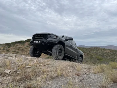

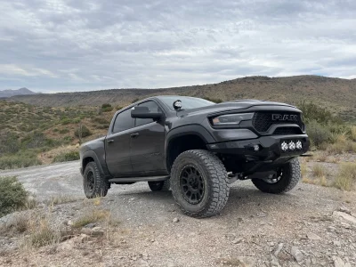

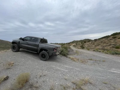

Thanks Coldfire -
With the weight of the winch upfront I think you’d be fine either way and better off with the taller springs. Keep in mind I did the full PRO lift, not leveling. I like the added height all around for 37’s and clearance.
The only reason I didn’t go with GEISER was that it was slightly taller upfront (3” vs 2.7) and I didn’t have that extra weight you’re carrying on the front bumper. If you’re planning on a lot of off-roading, GEISER is the standard imo. Give them a call, they’re great to talk with and crazy knowledgable on all things about our trucks suspension.
That said, I’ve got about 5K on my Eibachs with a decent amount of offroading here in AZ. It could be in my head but I swear the ride softened even more around the 3k mark. Both from carrying some heavy loads over distance and off-roading. Couldn’t be happier with the ride quality around town and on the highway. Soaks up rough pavement and potholes like they’re nothing. And on smooth pavement when you can find it out here, very much that Rolls Royce ride. At least what I’d image a Rolls is like. Never been in one!
Good luck, think you’ll be happy with the change.

Amazing truck, I gave GREISER a call and they explained that spring rate is 10 percent higher than stock and it's rated for higher weight. The only thing that got me a bit unsure is the disclaimer in there website which mentioned that the truck can became uneven and they will be held harmless in case this happens.
On the other hand, Eibach they don't have such disclaimer.
Maybe I would go Eibach route and do the pro kit.
