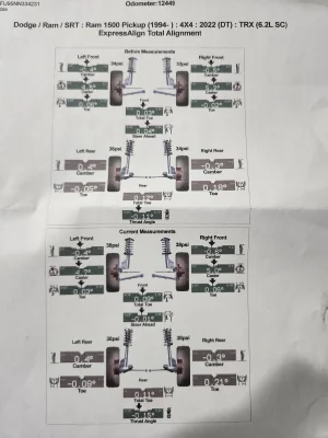

4wheelparts. They tried to get out of doing it once they saw they had to remove the rezzies & deal with active ride lol. They ended up doing a good job but took from 940 - 630pm. My final alignment sheet has 1 red box for Caster on the driver's front. They say there's no more room for adjustment but I'm calling BS b/c my before measurements had caster in the green so I'm going to bring it back for the free 1000 mile check-up where they'll check tq on everything they touched and get them to make the adjustment. I assume they were all ready to get outta there as it was 90 mins past close so I dont blame them. Truck drives pretty straight from what I can tell.

No issues with my alignment. Did you recal the suspension?
No im waiting to recal the suspension until after springs settle and i get my bumpers installed. I literally got home yesterday from 4WP at 730pm last night lol. I did some offroading today slow & high speed and have a lot more to share as well as some measurements. Will create my own thread so this one can be more about the pro lift
