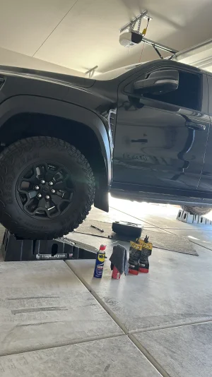

I changed mine for the second time today. The first round I used all mopar fluids but this time I used amsoil and it’s so much easier using a bag instead of bottles! I would 100% recommend it. Took me less than couple of hours! Thanks for the great info to the og poster. Copied the set up also ha ha 👍

I just used this kit today. I chanced it and did not go for the extra liter of T case fluid, I ended up with a few ounces left over.
Overall was a breeze to do following Tylers video and the write up at the beginning of this thread.
