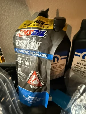

I decided to tackle this job since it cost me $334 in oil instead of +$1000 for the 4x4 service offered by my dealership. I don’t have a lift and not a lot of space in my garage (pictured).
My steel skid plates came off no problem, and I had a lot of room to do that. BTW, I’m 6’3”, so my wingspan is fairly long. The rear differential is the easiest drain, fill, plugged, done. The dealership did say the 5oz of limited slip was required. Whatever… I got it for $21.
The front differential was a tight fit from what I found. I could NOT get a bottle up in there to fill. I was unable to fill the transfer case because the Mopar Borg-Warner 44-40 fluid came in an oil bottle without a tip. Definitely some challenges.
What I ended up doing was reusing an Amsoil squeeze bag that I had left over from when I filled my transaxle for my 1973 Bug. I filled the bag with the Borg-Warner fluid and filled up the transfer case easily. Same for the front differential. If you have a squeeze bag, it doesn’t hurt to save one or two.
In case you want to venture away from the mopar brand, ravenol bottles have a built in tube that allows for pouring at awkward angles.

This worked well for me for the bulk of the fluid

I did Amsoil for the front and rear diff and Ravenol for the TC. I agree, the squeeze bags make things much easier.
