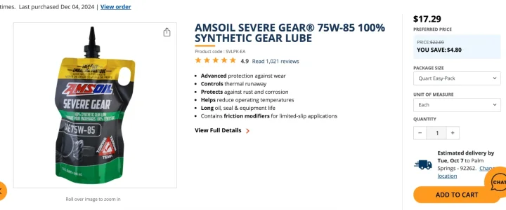

Does this look right? For front diff spec calls for 75w-85 I think, but from what I can gather in this thread, most are using 75w-90
If you really want you can run the 75w 85 they just made it for these newer trucks I picked some up but ran 75w 90 in my last trx no issue
just showing you they make it now
Yeah I saw that, I wasn't sure what the difference (if any) would be.
75w85 only exists to squeeze out an extra teeny tiny bit of fuel economy. Kind of ridiculous when you look at the TRX, but they just carried the spec over from the regular 1500s. I have 75w90 up there currently. Little extra viscosity never hurt anything.
