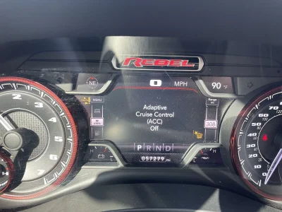

Hey guys just installed my switch on my 22 Rebel. When i hit the ECU Reset it still shows the error light for the collision avoidance and cruise control. I've reset it a bunch a times. Any tips on what else I can try?
I've unplugged the battery as well.
I also see that there is LIN ECU Reset. What's the difference between "LIN ECU Reset" and "ECU Reset" ?

This install will only work on a TRX any other trim level and you will need ABS module and the hcu, which are extremely expensive and a big pain for install.
Darn all that hard work for nothing :ROFLMAO: Thanks for the quick reply Tyler, your videos are great.
