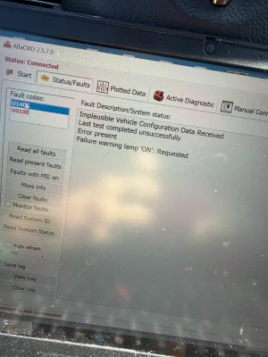

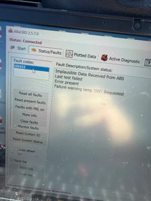

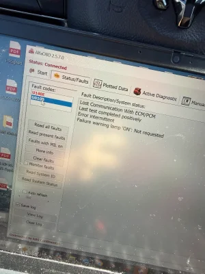

So I did this, step-by-step, and still ended up with a Christmas tree of dash lights, my heated/ventilated seats don’t work, and I have an trailer tow light, engine light, four-wheel-drive light, ABS light, and my truck is stuck in four-wheel-drive permanently. Is there a way to just reset everything?

I mean several of us have done this without issues. You may want to restore your backup and start from scratch again. Its something you missed.

I literally only did the two things.
I turned off reg CC and then turned on the ACC. But I think I had the truck running and that was the problem. Thinking about leaving the battery unplugged overnight. 🤔
it’s in AlfaOBD

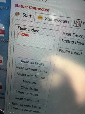

Did the ECU reset. And it didn’t help.
I have this 4wd code, trailer brake code, and abs codes that keep coming back over and over.
C2206 was the first code that I got and it comes right back even if i reset it.

Restore it to you original back up if you saved it and start over. If not I believe you have to go back the dealership and have them upload your OEM factory settings

So I put it in service mode, and then I reset the cruise control settings back to Factory, but no matter what I still keep getting the same codes over and over again even after i clear them.
