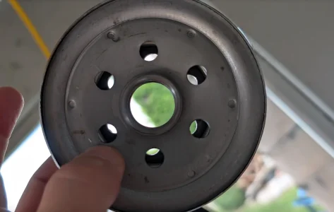

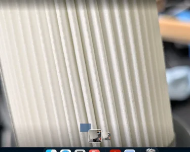

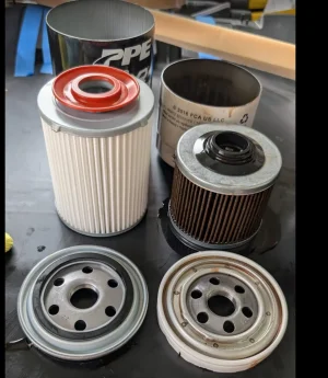

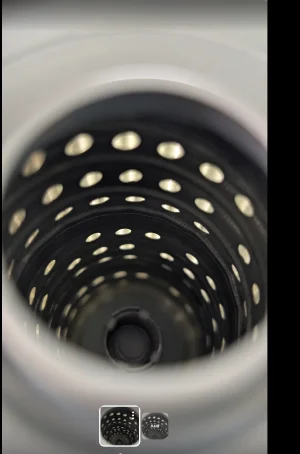

So I did cut it open I am impressed I don't have access to test filters like the other member ...but cut it open new I know lol I am very impressed looks like a synthetic media filter nice anti drain back valve heavy duty spring so bypass open at 32psi.. built in magnet my biggest concern was flow so we don't starve our motors the end caps line up and the holes look similar ish one wider ppe and the srt is closer in to the center and the center core looks to have enough holes to flow time will see I was worried at such a low micron will it restrict flow ....
