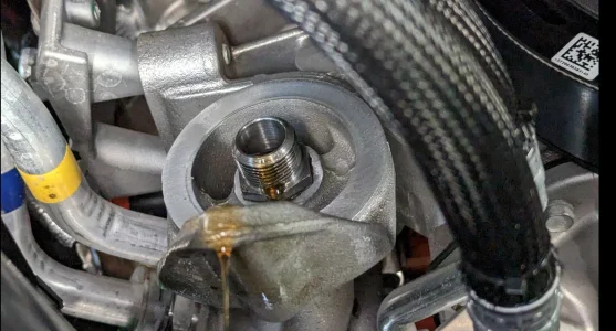

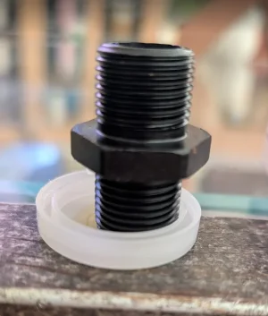

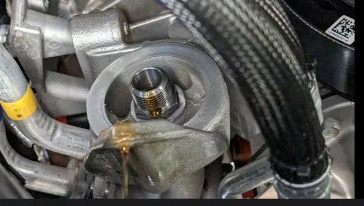

So I bought this to try to fit it in the oem housing I won't know till I do my next oil change will keep you posted . hey $16 dollars is much cheaper than $300 OIL FITLER RELOCATION KITS ...
worth a shot plus I can't send photos in private messages so I post here lol

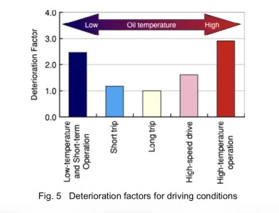

On one of the two 'Cats you were kind enough to go over the analysis results on, and said they were good to go for another 3,000 miles, I checked the oil life on the EVIC today.
It has about 250 miles on the oil since the last change (years ago now) and the EVIC said 10%. But here's the kicker...I have never reset that oil life thingy, so in an '18 with 5,405 miles on it, it still claims about 500 miles to go on the factory fill.
Here's one for you OnTheReel.
Yeah, doesn’t seem like Mopar takes overall time in the sump into account, which is interesting considering they call for 6 month intervals. From what I remember my GMs did. Anyway, besides the crazy passage of time between then and now I’m not surprised it still thinks there is 10% left when you look how you operate the vehicle. Most of these OLMs are programmed to be heavily weighted on oil temperature. Both too cold and too hot are calculated into the degradation factor. You probably spend the vast majority of time in the sweet spot, so to speak. Easy on oil.
I usually get at least two changes done before the OLM actually says “enough” and I have to reset it but otherwise I never even look at it. There’s no reason they can’t be more accurate than they are, but most just aren’t fed all the data needed or they are skewed to just kick the thing through the warranty period and not much more.
Reactions: Two
It's pretty much a combination of "long trip" and "high speed drive". But I suspect that my trips are longer and the speeds higher than what they count on.
By the way, the latest oil change was o 12-11-23, 267 miles ago. I really should drive my favorite vehicle more.
