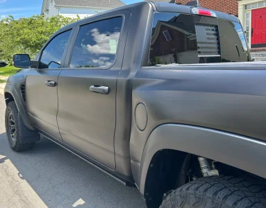

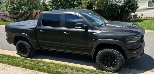

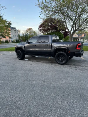

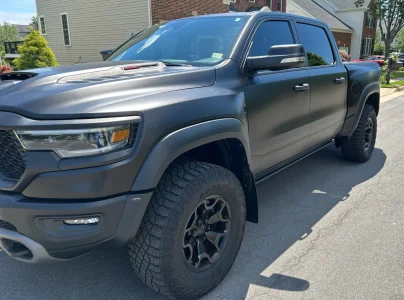

Wrapped it, tinted it, and ceramic coated the trim.

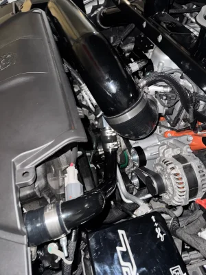

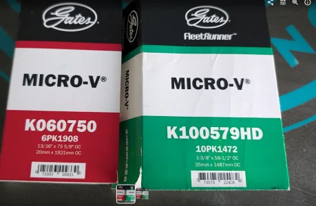

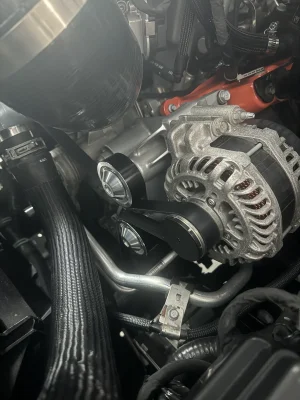

new belts
this is what I used everything stock so far
100 miles so far

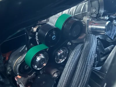

Looks great, I have the same set up, love it.
You can do the lower smooth pulley as well (can’t really see it easily but did it anyway) and accessory belt pulleys to match.
Nice, I’m gonna do those accessory pulleys next for sure. I hate the shitty plastic ones it came with. The other supercharger idler I’ll probably leave alone for now. I was tempted but like you said, it’s kinda buried down there.

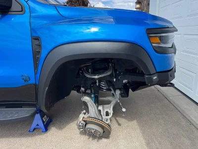

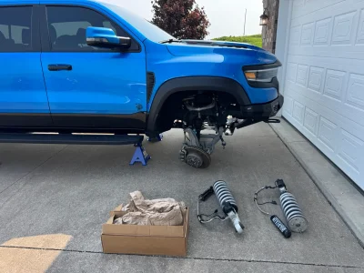

1.6” Eibachs installed today. Waiting on a tool so I can do the rears, should be complete tomorrow.
Measurements:
Front 40-7/8”
Rear 41-1/4”

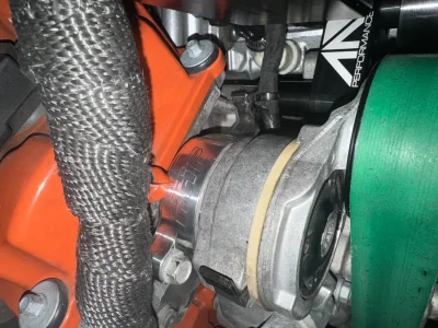

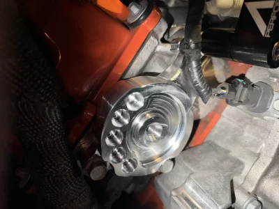

Agreed, those stock pulleys are ugly and heavy as shit too. These billet ones look awesome.
I did the adjustable idler bracket for some additional bling too. Once I change the upper supercharger pulley, I will have all the adjustment needed.

You’ll definitely loose even more weight ditching the stock blower pulley. Things a real brick.

Dang that is heavy. I haven’t figured out which pulley to go with yet? What size did you go with and what kind of tune?
Griptec 2.95. Weighs maybe 1/4 of that stock one but isn’t clutched so I did pin the lower to be safe. Flex fuel tune through Dusterhoff (DT937). Perfect TRX setup IMO. It rips when you want it to but drivability is as good as stock and nothing is really stressed too much at this level. Can still tow my boat and do whatever else I want.
