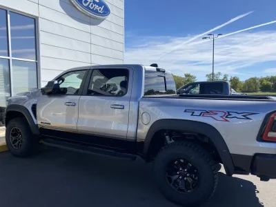

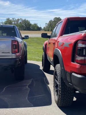

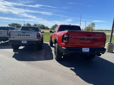

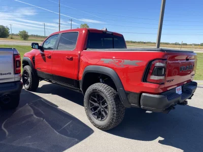

Here you go :)

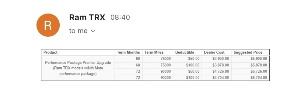

Anyone thinking of doing this and wondering about the “Tyrant” warranty that’s offered with the package…they do have a few options above the 3/36… figured I’d share for those who are interested.
