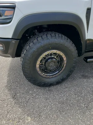

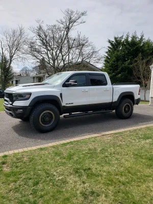

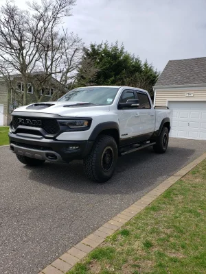

I just bought a 2021 TRX, I ordered 37 x 12.50 x 18 Toyo AT 3 tires for the truck. I want to change the stock rims. I know the stock rims are 6x139.7 bolt pattern, I know that the stock offset is +19 and the stock rims are 9 inches wide. If I get a new rim that is 9.5 inches wide, how do I know what the new rim offset should be? Do I have to have to have the same +19 offset on the new rims? or can it be just close like +12? Some rime that I like will fit but the offsets are different for a lot of rims that have the right bolt pattern. Can anyone help explain? Does it make a big difference for the offset from a 9inch stock rim to a 9.5 inch new rim? Stock tires are 13, my new tires are 12.5.
I'd probably try to stick with a +20 to +25 offset if you can find it. +25 would have the outside of the wheel sitting at the same location as the stock wheels, but the inside of the wheel would be further in. I don't think you would have any clearance issues on the inside with that minor of a change, but I don't know for certain. Since the 12.50 is a little more narrow, you might get away with a 9.5" wide wheel that has a +12 to +15 offset, but some rubbing might happen.
It worked out perfect, the new 37 inch tires and the new rims look awesome with no clearance issues at all. Thanks for your feedback!
Also, the offset on the new rim was plus 12 on an 18 inch rim, worked perfect with the 12.5 /37/18 Toyo tires.
Can you post a picture of the finished look/stance?
