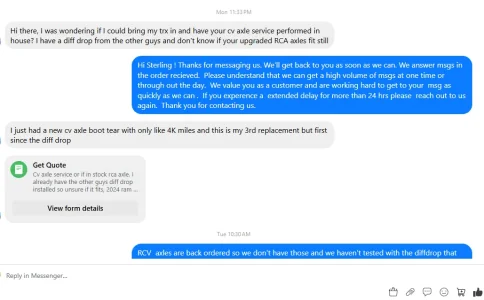

@RogueOffroad can you post photos of the diff drop kit?
We have a coding issue on the site for the TRX and RHO catagories. In fact all last week no one could go to trx or RHO as we caused an issue we are working on this. but taking care of the whole section is a priority vs the products that we lost photos of. Plus we have our day-to-day and its only 3 people in the office trying to do all this and I suck at the website stuff. Fortunately, I didn't cause the issue. Wait maybe that's bad, HAHA. Hang tight .
