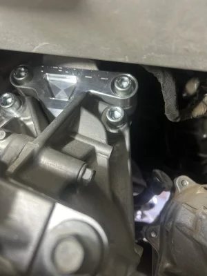

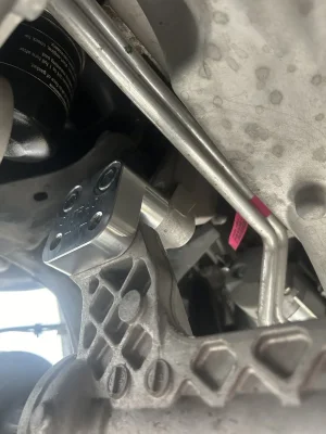

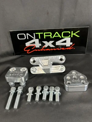

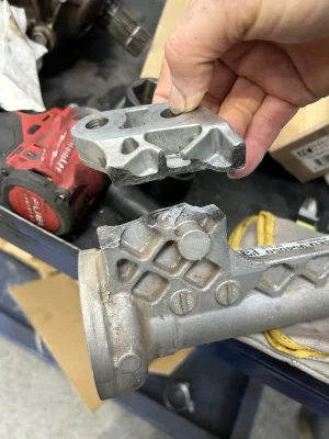

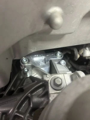

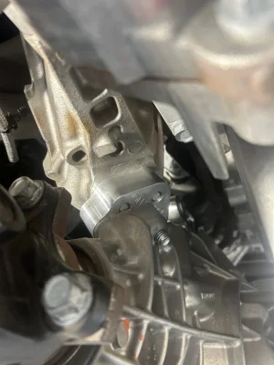

Attached is a few photos off the diff drop installed and a new axle tube assembly designed for the trx as we have new seen a few break. (The axle tube assembly is yet to make it onto our website but will be there shortly.

Its a 35mm drop, made from 6061-t6 billet aluminium.
Made in australia,
Has a full detailed instructions
All bolts and hardware is supplied,
Only specialty tooling needed is a holesaw.
Diff assembly can remain in the car while being installed.

This drop kit is similar to those available for other brands (GM).
It relocates the fixed axle/diff housing about 1.25" lower.
There is no increase in ground clearance. To increase ground clearance you would add new springs or spring spacers.
There should be no difference in how the truck feels on the road.

Your 100% correct in this one, the most challenging part off this project was because ram mounts the front diff off the engine mounts rather off the chassis. So there was alot off cad work involved.

Did you see the billet axle tube we did to stop the right hand side mount from breaking off??

There are no moving parts to the kit, so wont be any wear or tear, no draw backs in stability, except for the fact you may loose 10mm of ground clearance when the bash guard is re fitted.

That i cant tell you, but in some instances we have had to space even the factory plate by aprox 10mm
