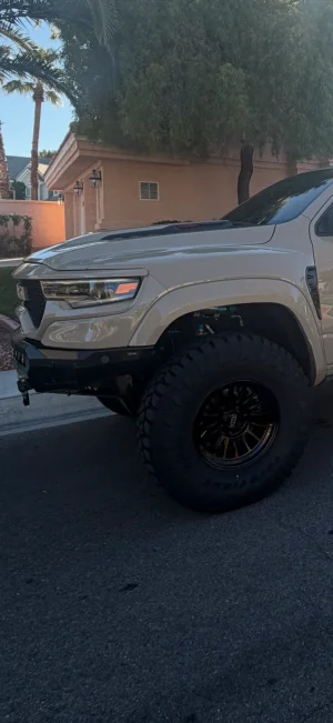

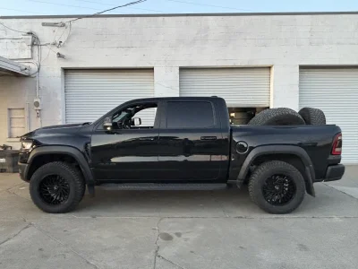

I’ve had this pic for awhile and tried searching this thread and the color appropriate thread but couldn’t find the specs or owner. Just wondering what the wheel specs and suspension mods are. This is the exact look and stance I’m going for.

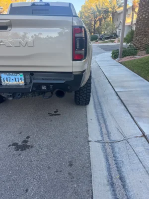

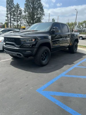

I'd guess 37x13.50R18 with 18x9 with 0 or maybe -12 offset and a level kit. Looks like maybe the rear is raised a touch as well, so maybe geiser springs front and rear. The pic below is 18x9, -12 with a Rouge level kit (no top plate). No rear suspension lift, and it looks a little shorter than what you posted.

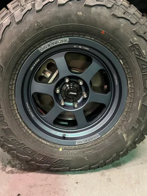

Method MR305 18x9 +0
Toyo MT 37x13.50
King/Kibbe suspension
Minor trimming for strait line full stuff.
Pretty major trimming for full stuff full lock.
Is there any rubbing with this setup? I'm considering the same setup but with RT Pros

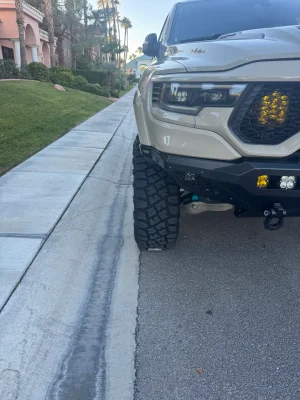

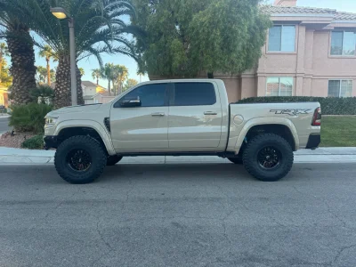

Decieded i should post here since i got alot of info here to make my purchase 2 years ago.
37x13.50r2 BFG KM3
20X9 -12 KMC DESERT GERNADE.
1.6" EIBACH FRONT SRPING
Some rub when wheel locked on uneven/hilly surface. I did trim front fender liner on the inner side.
Sorry not the best pics
37x13.50r2 BFG KM3
Sorry not the best picsView attachment 158071
Hot damn those KMC's a beautiful!
