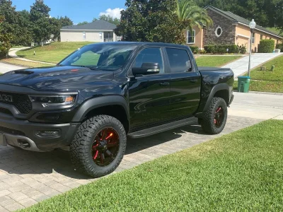

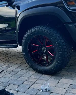

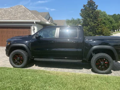

Off-road Monster M08 20x9 with Nitto Ridge Grappler 35”.
No rubbing.

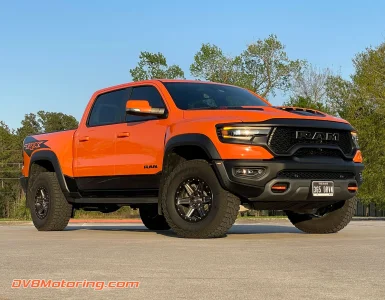

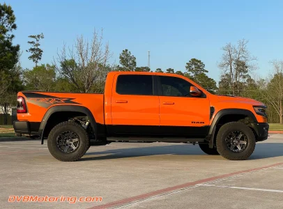

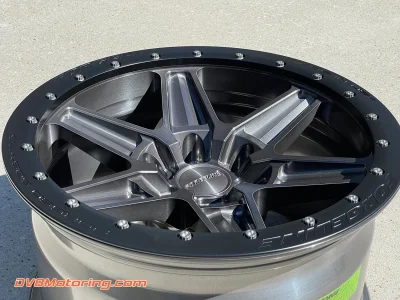

I collaborated with Forgeline to design a new wheel style for our trucks, which includes a bolt-on ring. These are 100% forged, CNC machined wheels, made in the USA. Our premium TRX trucks don't deserve low-quality Chinese wheels.
Forgeline FX1 Beadluk (simulated bead lock)
18x10.0 +12 front and rear
OEM 35" tires, stock suspension

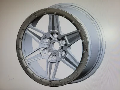

These Forgeline wheels start at $8500/set in standard finishes. There is a lot of CNC machining time in this design. For those who only want the best!
Those are some amazing wheels but that is a lot of cash for wheels. Forged beadlock race wheels on Trophy Trucks cost half that.
Those generally aren't concave forgings, nor do they have the machining details or run time of these. We can certainly build less expensive, less detailed wheels, with normal flat profile forgings and minimal CNC time. It just depends what a buyer wants.
I'm definitely no CNC expert and can appreciate the time and quality. Just comparing for my use case as the truck sees a lot of dirt time.
Those are badass. I have the Forgeline wheels on my viper and the quality is absolutely amazing. What all options do we have from Forgeline for our truck?
