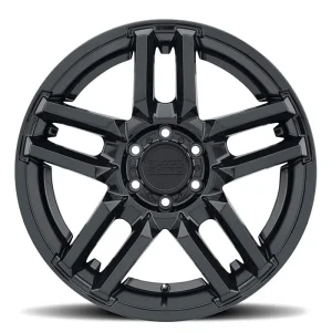

Here is my contribution:
Trimming required: None

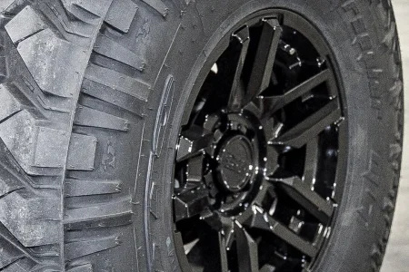

what would a +12 offset do? would it move the tire out 7mm or in 7mm based on the factory stock offset of +19mm? and being less than a third of a inch difference do you think this would cause any rubbing? The list below is what I want to put on my new TRX, thanks

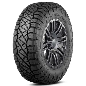

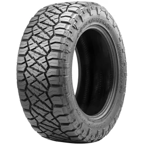

Tires/Nitto Ridge Grappler
TIRE SIZE
37x13.50R18LT D
Overall Dia (in) Inflated Dimensions
36.77
Overall Width Inflated Dimensions
13.58
APPROVED RIM
9.0-(11.0)-11.5
WEIGHT
89.02

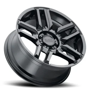

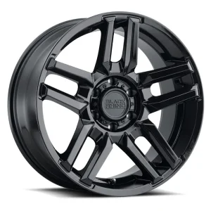

Rims / BLACK RHINO MESA
Size / 18x9
Offset / +12
Back Spacing / 5.470
Weight / 35 lbs
update

The pictures are not the correct seizes, just wanted to give you a idea of the look I`m going for.
TIRE SIZE
37x13.50R18LT D
36.77
13.58
APPROVED RIM
9.0-(11.0)-11.5
WEIGHT
89.02
Size / 18x9
Offset / +12
Weight / 35 lbs
It will move the wheels outward from stock. With a 37x13.50 and stock suspension it will potentially rub, but maybe not very much.
I`m really new at this stuff, forgive my ignorance, BR list the Back Spacing / 5.470 on this rim. Is it possible to put less Back Spacing in moving the rim back in to a 19mm offset? Or is the Back Spacing built into the wheel itself? Thanks again for your time.
Wheel manufacturers often have different back spacing options in the same style wheel. It just depends on whether they offer it in the correct offset in the wheel you want.
What is the stock wheel Back Spacing? Thanks
18x9, 6x139.7 bolt pattern (also known as 6x5.5), +19 offset, 77.8 center bore, M14x1.5 lug nuts.
One other thing to keep in mind is backspacing takes into account the width of the wheel. Offset only tells you how far the mounting surface of the wheels is from the center of the wheel.
For instance, +0 offset is in the middle of a wheel. +19 offset means the mounting surface is 19mm towards the outside of the wheel (from center), thus moving more of the wheel inboard. If the offset was -19 then it would move more of the wheel towards the outside of the truck.
Since backspacing takes into consideration the width of the wheel, it only tells you how much of the wheel is inboard or outboard from center. On a 9" wide wheel with +0 offset you have 4.5" of backspacing. On a 10" wide wheel with +0 offset it would leave 5" of backspacing. When you start to change the offset it will start to change the backspacing, but you still have to figure in the width of the wheel. There are several calculators online that do the math for you if you want to look at options.
Generally speaking, this is what I have found:
+18 to +20 offset on a 9" wide wheel you can run 37" tires with no suspension mods.
-12 offset on a 9" wide wheel will require a level kit to prevent rubbing with a 37" tire(and it may still rub a touch depending on your tire choice).
Any offset between those two options will allow some compromise between tire height, width, and need for suspension modifications. Again, tire choice can impact the results since not all tires are the same height and width in a given spec.
If you want to run 35" tires, you can start to push the offset further negative than -12 (more wheel sticking out from the fender). I don't have any exact numbers, but I think some guys are running -18 and even more with 35s without rubbing.

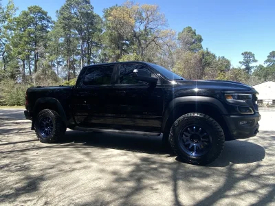

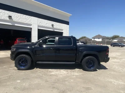

Horrible pics due to the weather but here are the new wheels/tires on my TRX. These are Weld Ledge 6’s in 20x10 with a +13 offset. I intentionally wanted to keep the tires slightly tucked in the fenders like stock to reduce the crap being tossed up the sides of the truck. The tires are 37 x 13.5-20’s.
I have the smallest amount of rub on the drivers side when full lock to the left even with the Rogue leveling kit installed. I only have the perch spacers installed not the top spacers.
I was able to heat the bottom of the wheel well liner and form that out of the way but at full lock it is still just touching the very inside screw head for my mudflaps. Might leave them off, or try a flat head screw for the flaps, etc. until Geiser releases their spring set which sounds like it will lift it a bit more and hopefully clear.

Do you think 12.50’s would fit better or finish the leveling kit?

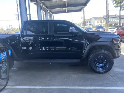

Too bright for good pics but got them on now, one of kind, for now…..
